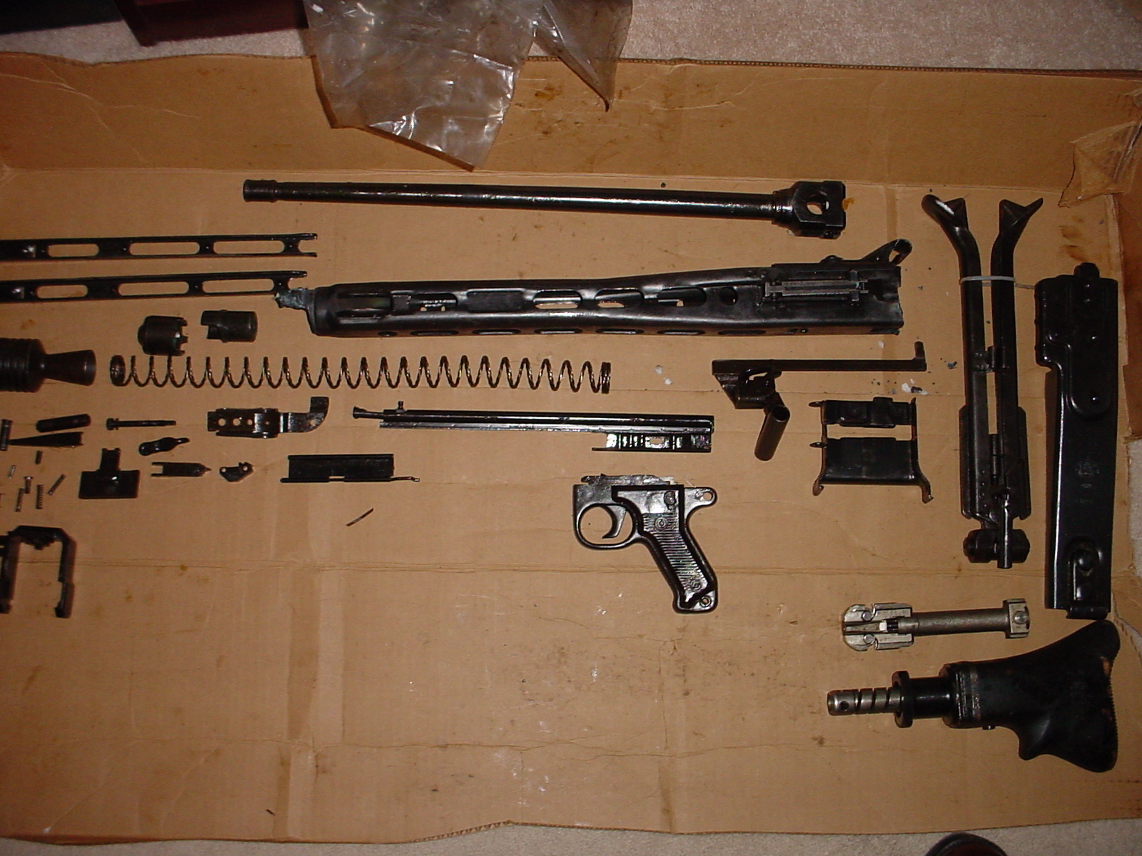

My Sarco kit just arrived at work so I haven't had much time to look at it, though I did look down the barrel. Really nice lands and grooves no apparent corrosion, that alone was worth the cost of the parts kit. I will try to post some pictures as soon as I can get it out of the box and lay it out.

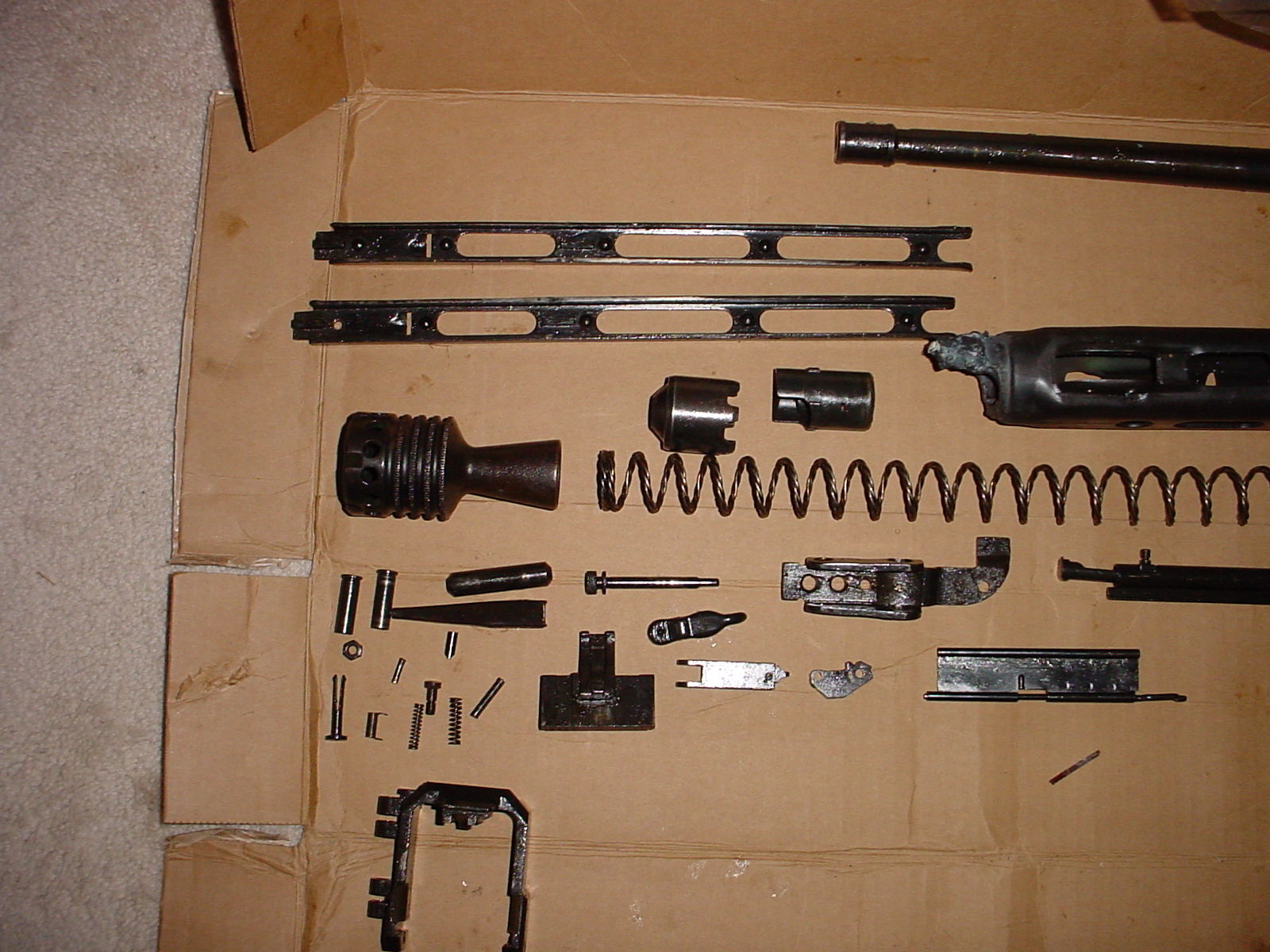

Post by vik »
Here are the pics of the Kit, everything is clean with minimal scuffs and/or scrathes the barrel is nice with great lands and groves. The kit came with a bunch of screws and tiny little pieces...all in all well worth the price Sarco was asking.
88 and vik-thank you both for the pics.Vik,was this one of the $200 kits? If so,you got a good deal! ---bil

Some people have all the luck. My barrel is beyond hope. I returned your picture with some observations and questions.
*The X2 means there should be two of them
*The ? means what the heck is that
*Extra means I think you only need one
Check to see if the spring is inside the hole I point to. If not you may be missing a spring. I guess for 200 bucks you take what you can get.
