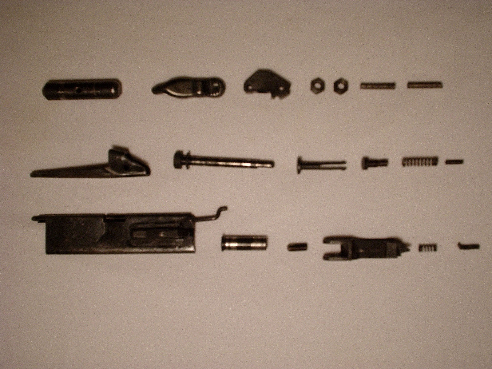

Can you folks take a look at this picture and tell me if I’m missing anything. If necessary I can take a close up of the smaller stuff. I’m at a total loss for what I need to do with thing now. What’s my next step?
I’m use to Kalashnikov style kits where all you do is buy a parts kit and a receiver then rivet them together. Will the new BRP make it that easy, or is there something else I need. Is there any pricing yet on this new receiver?
The barrel isn’t too bad inside and I can definitely see rifling. It’s not super crisp on the edges, but is at least as good as my 98 Mauser I use for hunting, which is dead-on accurate at 200 yards, so I’m satisfied.

This looks like a good kit,nothing missing that I can see-I still dont know what the part at the 1 o'clock position is ,below the butt-stock,the lower of the 2 pieces.A small lever with ribs on it.I have it in my 53 kit ,but not the 42.Anybody? You will need to get the barrell bushing repair,it is availlable fromwise-lite,through Apex.A link and how to install are here on site-use'search' No word yet on receivers or the prices ,either.Unless you can get a German cut receiver,I dont know.I am not sure if BRB has them anymore.Good luck,and have fun! ---bil
Here's another picture of the smaller parts. I've read about every sticky on here and I'm still a bit confused how you go from this kit to a buildable gun without buying the 3 piece cut receiver.

I noticed in another kit picture someone showed on another thread they had two small square pieces that mine doesn't have. Looking at RTG Internationals site I see parts called buffer tabs, which I think is what they were. If I need these, at $32 for the pair I probably won't go broke buying them there, or should I go back to Sarco?

OK - Parts ID on this page.
Top row - left- first piece looks like the safety button that goes in the trigger group, not sure, as its not clear.
next to that is the latch that holds the butt stock in place, mounts on the bottom of the receiver, on the part you don't have yet/
next- triangular piece - heart of the forward sight, used with the two pins on the right.
Nuts - might go with the spring assembly (forget the name) that pushes the barrel forward.
Next row:
left- finger that locks the muzzle/flash supressor in place - part of the front sight assembly.
next to that: Top cover pivot pin,
next is a split pin - I don't have one on my '42 - I'm clueless
next - if it has a square top and is threaded it goes with one of the nuts above, and the barrel recouperator (?) for pushing barrel forward.
Spring - may be the one that fits in the triangular piece for the front sight. fits in a hole.
Tiny pin - ? I forget...
Bottom row, left
Cover, goes on the bottom of the receiver, covers the discharge opening for the empty brass. Most/many semi- autos don't have these as the bolt has to kick it open when going by on the first shot. Since the bolt is modified, this doesn't happen.
next - looks llike the trigger group retaining pin - fits in the hole behind the trigger. Allows the entire assembly to be removed.
next- small pin, front sight and spring - these all get used in the front sight assembly. the pin rubs against the bottom of the sight, a spring causes that to happen - not sure if it is the small one here or the longer one above. Two springs are used of the front sight assembly.
last little pin? I don't know - in a little hole somewhere?
Next row:
Bottom row, left

Ok-
For those of you with these parts in hand (above), you can start figuring out how the front sight goes together. You will also need the barrel shroud - probably the largest piece you have. It will have the mount on it, in the front on the top (duh). The two pins will hold everything together and on the shroud.
Puzzle time ! The front sight will fold down flat, toward the back, when not in use. The finger that goes to the front will only lift up 1/4 to 3/8" to allow the muzzle/flash supressor to be rotated for adjustment or removal.
The triangular piece will be held to the shroud by the two pins, and the holes on it will match those in the shroud (surprise!)
The rest I will leave up to you- the springs don't make it easy. Maybe start without those in place. Think like a German engineer -logical, frugal and idiot proof, once you have seen it once.
Once it all works (and it will) remember you may have to take it off to weld on the front threaded nose. When the nose goes in, remember the sight assembly and that it needs to go back in - be sure it will all fit (it should).
It is a puzzle that many of us have been through. You can ask better questions if you have been playing with the parts. Really it is an incredible design. One of these days I'll get some pics up to help out. It can be done. We're here to help.
Chris
Chris

The new receivers should be long enough to weld up to what you have.I don't know if they will have the 'ratchet plate',they are availlable fromRTG,anong others.$22 for the old style. i am not sure why there are 2 styles. You will also need the rails ! pair.they are avial.from various sources.You will need rail rivets,they are avail from me for free to members here,send name and address in PM,I will sent them to you,I ask that you make a donation to the site.The buffer tabs may or may not come with the new receiver-RTG and others have them.They are riveted in,so take that into account.There are other rivets needed,Is your barrel gate still attached? A lot will depend on what the new receiver has with it.These parts are riveted on-FCG/lafette mount,front site,rear site,AA sight[if aplicable]cam section,buffer tabs.Ratchet plate is spot welded on.You will also have to have the semi mods,you can do them,or have one of the guys in the 'services'section do them. This should give you a basic idea of what you need Good Luck! ---bil

Top row - left- tripod cross bolt - .88comm wrote:OK - Parts ID on this page.
next to that is the latch that holds the butt stock in place, mounts on the bottom of the receiver, on the part you don't have yet.
Nuts - might go with the spring assembly ( recuperator) that pushes the barrel forward.
Next row:
left- finger that locks the muzzle/flash suppressor in place - part of the front sight assembly.
next is a male split pin - used with the larger female split pin below to hold the Gripstick on
next - rear recuperator bolt it goes with one of the nuts above, and the barrel recuperator (?) for pushing barrel forward.
Bottom row, left
next - looks like the trigger group female split retaining pin - fits in the hole behind the trigger. Allows the entire assembly to be removed.
i just added to 88's post rather than retype everything. you can find detailed info in the mg42 stickies to answer lots of these questions
