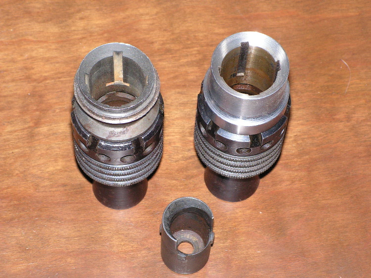

gdmoore,
Thats verry interesting to see the Wiselite piece without the divet. Do we know if anyone hase one of these in a working gun? and if so can they still change the barrel?
Also I edited my post after checking the thread count, it is 16 tpi, but I dont know the pitch or the deapth.

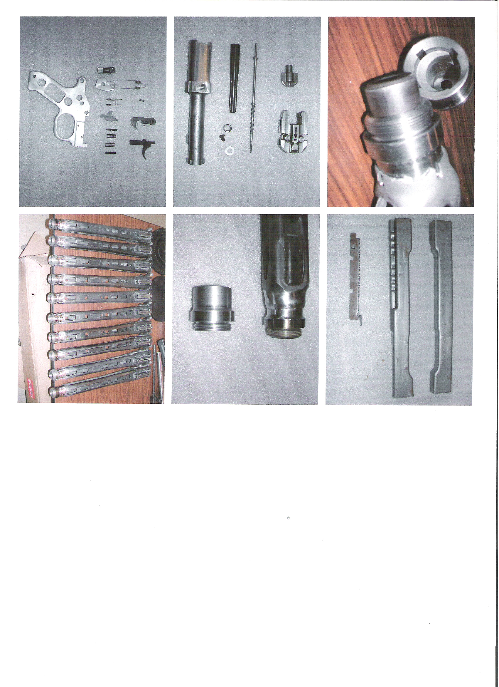

L.R.--
I just went back to the first pictures posted here by Wiselite of their new components. Oddly, the replacement barrel bushing sleeve pictured there HAS the recess cut into it. So, I don't know if they decided that it was unnecessary or if they simply forgot to machine it.
Has anybody else who bought the Wiselite replacement sleeve noticed this? Let me know whether all of them were machined like this or if I got an incomplete one.
(Wiselite's original picture of their MG42 components pictured below.)
Wiselite Components.jpg (1.86 MiB) Viewed 2105 times

Gee:
Both my Wiselite bushings are like the photo. Mine aren't welded in yet, but they are a tight fit in the shroud, and stay put when you mess with them. The barrel goes in and out like it's supposed to. My guess is that the extra cut isn't necessary, so they omitted it.
The MG3 bushing I have, doesn't have the cut either. BTW, the drawing is the MG3 bushing.
Bushing comparison.JPG (227.82 KiB) Viewed 2091 times
