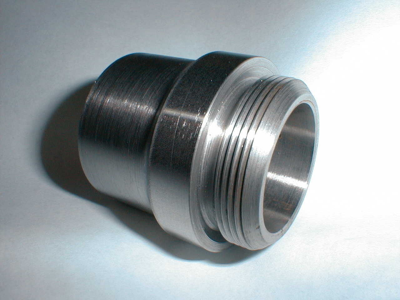

rocco and myself are looking for the replacment weld in buster adapter, the part that gets torched in these kits. I cant find the correct part on those sites listed above. If any one has one that was cut off in a kit (with some of the shroud attached) this would be acceptable, as we can disect it from the shroud remains and reuse the part.

Wise Lite Arms manufactures a very good replacement part. It welds into the front of the barrel shroud. They also make complete semi-auto trigger groups and can do the bolt mods. All the parts and work are offered through:rocco1911 wrote:Sorry I meant the Replacement threaded Barrel piece to repair the torch cut booster area on my M53. Any body have one they want to sell or is there a place I can get one??
http://www.weaponeer.net
Buy the replacement barrel bushing sleeve from Wiselite. Weaponeer did a group buy at $100 each but that buy is closed. Several of us here bought some, and they came from Wiselite, who announced that they would make them available directly for $125 each plus shipping.

- Wiselite Barrel Bushing 001.jpg (186.98 KiB) Viewed 2357 times

Rocco-look in the 'wanted' section-a threan from earlier called'mg42 or yugo 53 front section'.I posted some pics of what you need.It shows the wise-lite repair part next to a cut-off receiver front.URAR posted measurements for length around the same time.This should help you out.No,the cut-off is not for sale. ---bil
