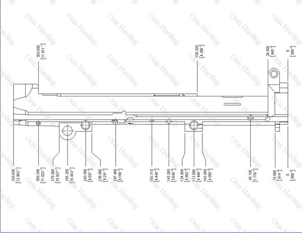

Here is a drawing showing the major dimensions needed for re-welds.
All NFA rules apply.
You can see the full size drawing here: http://www.autochart.com/MG34/MG34RecBasicDim.jpg

Thank you for posting this ... :wnana:
Re: MG34 Receiver Basic Dimensions
Yes,thanks,Orin.I tried to do this once and made a mess of it. :( It will be handy when I try to figure out if I have enough material for a receiver. ---bil

Glad to help guys. Let me know if you need any other dimension.

As said before MANY THANKS for posting this...

Thanks 762x51 for posting the good info
Does anyone know if any 34 rec ordnance drawings exist for all the dims of the 34 rec to scratch build one???

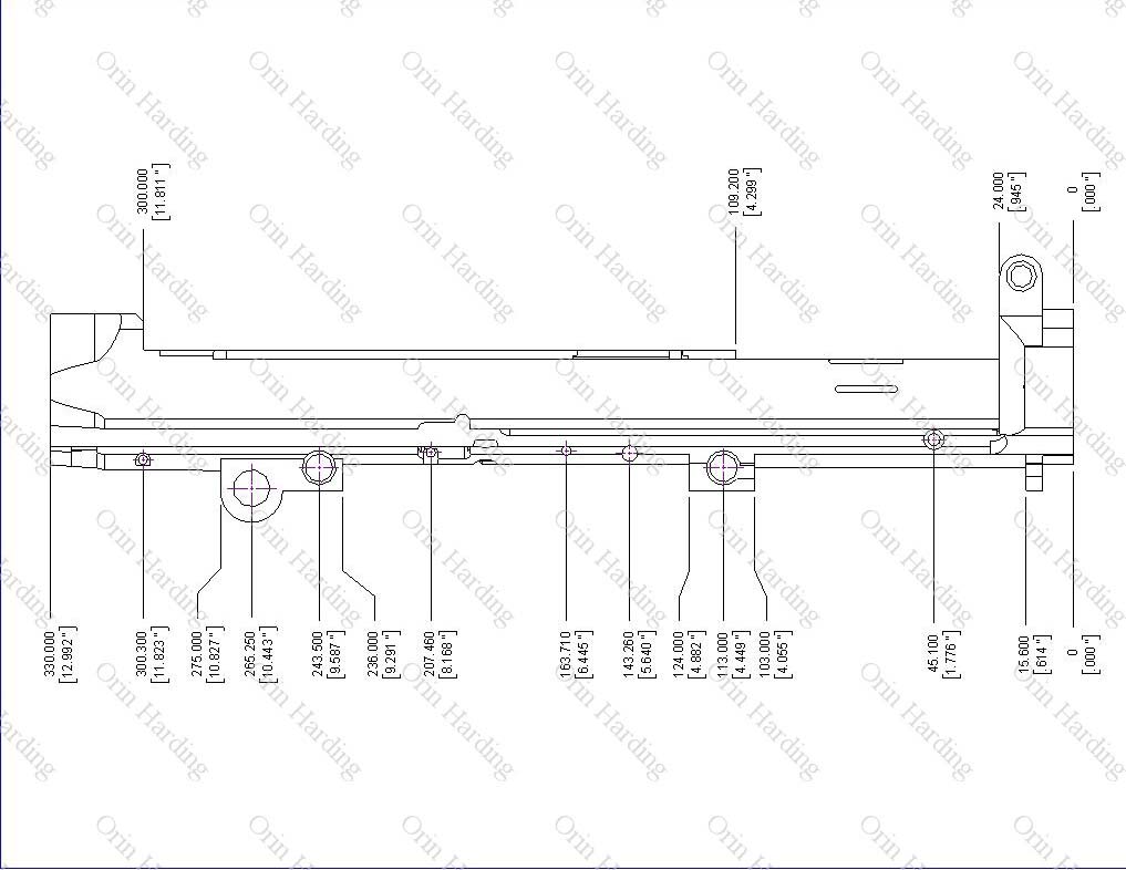

Does anyone have the front end blue prints for the cam location and rivet holes? Thanks.

Interesting. As far as i can read blueprints this info is NOT in the J&G/ Farquist prints.
Would it not be in the TNW semi package?
