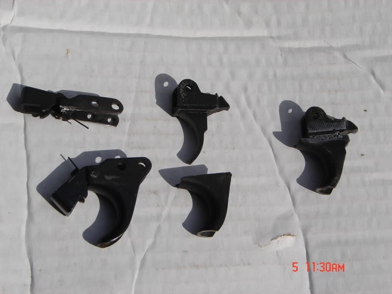

I never liked the FAL trigger in the gripstick its too narrow , looks way wrong, and was traveling too far back and causing me some hang-ups and trigger slap.
So i cut an original and welded it over the FALs and then notched the original JUST enough to release the hammer . i feel it was a big improvement and since i'm posting pics today thought i'd share.
All the parts layed out

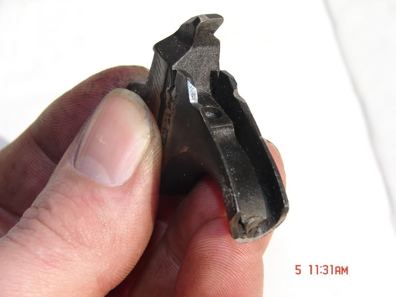

weld at the tip of the FAL trigger

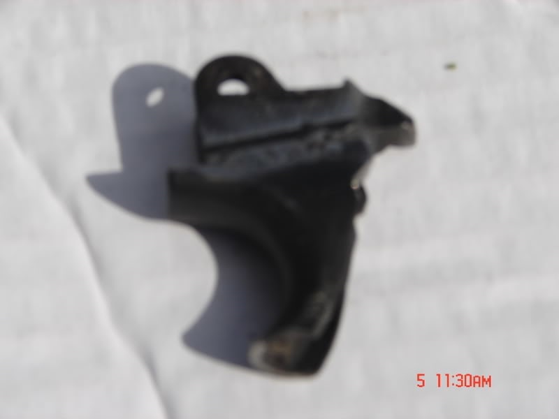

Side view trigger shoe before polishing the welds & reblueing

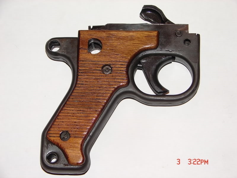

Trigger shoe installed ready for testing
Original gripstick for comparision
