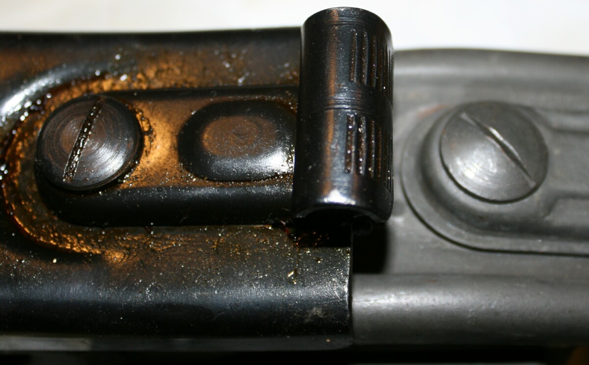

I don't think they are, I've looked at as many pictures of the top cover latch screw as I could and it seems significantly shorter than the barrel change door latch screw - at least on the one that came out of this gun, there's a much taller unthreaded section on the barrel door one where the top cover is threaded all the way to the screw head and significantly shorter. If someone who knows these guns can confirm they are the same or useable then I'll order it, I've seen that screw on RTG and thought I was lucky but I don't think so

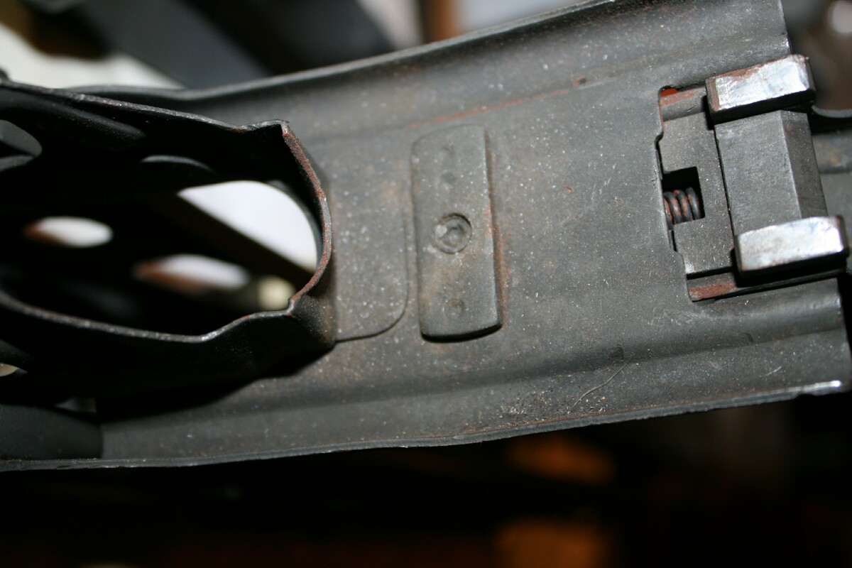

The problem with getting a used screw is that someone getting it out of the door latch will likely break off the peened part that makes it stay in place.
Posts: 3323
Re: WTB: MG42 Barrel Change Door SCREW (large flathead)
What John is talking about. See how it's staked.

See the head difference -- German Top cover on left, German barrel gate on right

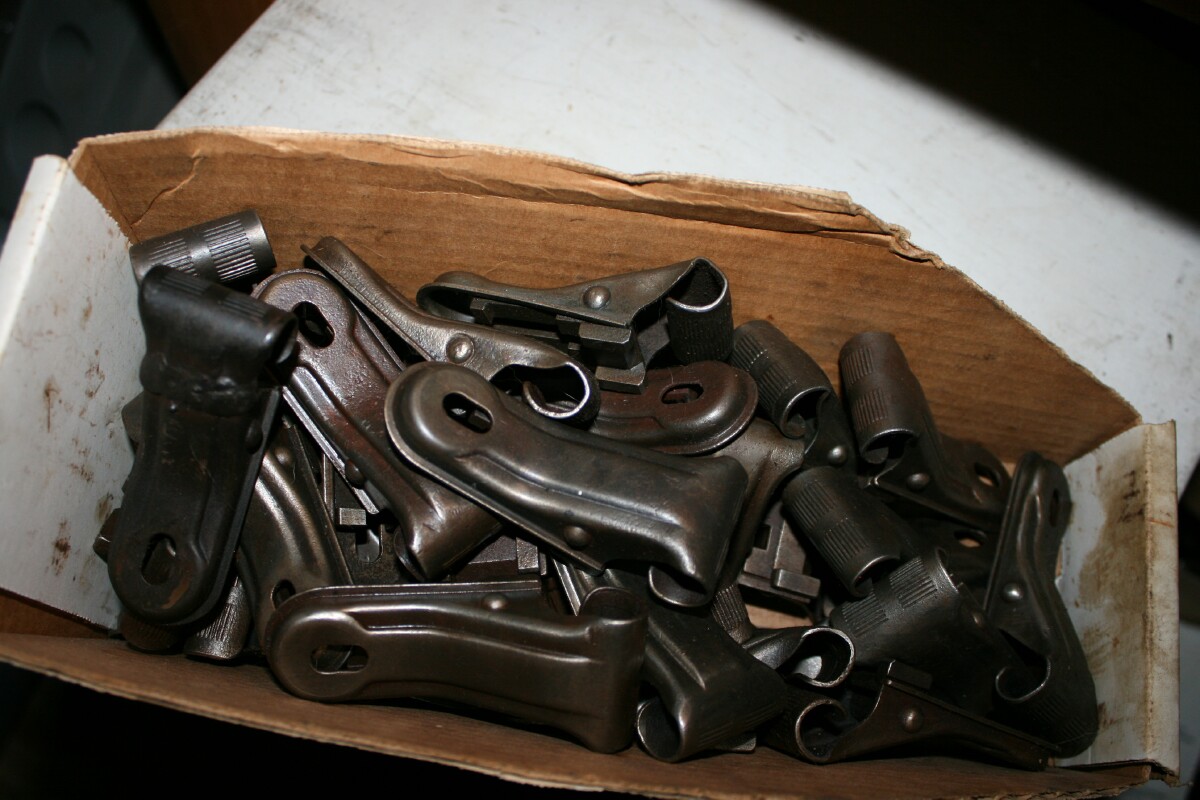

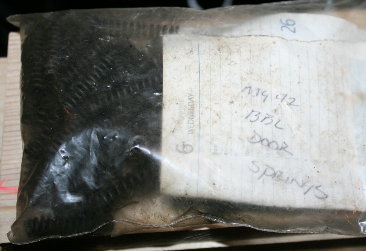

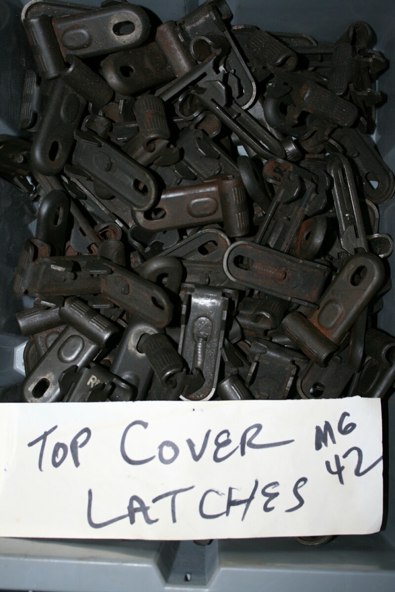

Some of my other stuff

If you get the hole re-threaded and the screw is secure when you assemble it, you can always use black (permanent) loctite on it. Red loctite is good too, but it can be removed by heating to 500 degrees F. That's the temp when it degrades and allows unscrewing it.
Or you could just tack weld the hole from the back.

Torch the staked part almost cherry red and use a big flathead to remove.Did this on a couple topcovers that wanted to replace the rivet from m53 shroud.will come right out.The flare is not that bad.
