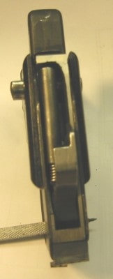

- Top assembled
- 1.jpg (9.67 KiB) Viewed 9979 times
- Extra material removed from grip stick inside and front bushing/shelf added
- 2.jpg (17.82 KiB) Viewed 9979 times

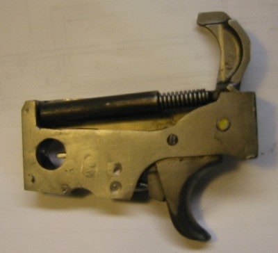

- Stripped cage bottom including trigger return spring box
- 3.jpg (16.17 KiB) Viewed 9979 times
- Stripped cage top with trigger rear limit stop
- 4.jpg (16.4 KiB) Viewed 9979 times

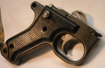

- Presenting..... Lima's original outside profile FAL grip stick with working safety!!!!
- 6.jpg (20.13 KiB) Viewed 9979 times

Very nice!!! Just make sure that the FE grip cannot be fitted-I know you addressed that in the tutorial,but does the receiver itself need to be modified to be legal/ I am unclear.Anyway,nice engineering. ---bil
Re: Fancy new FAL grip stick
I am using a BRP approved semi-auto receiver front and rear sections that arrived addembled as an FFL item. I milled a slot in the receiver and welded in the semi bolt blocker bar provided by BRP.
The front of the grip slot where had the FA grip would mount was removed by BRP before I got it to meet BATF requirements. The shape of my front retainer piece does a great job of grabbing what little metal is left between the trigger slot and ejector slot.
To prevent FA parts from working in the grip frame without my FAL cage, the holes will be reamed oversize, filled or removed to prevent FA parts from being installed in the modified grip frame.

Michaelj - The only thing I touched on the outside was a plug weld in the front. It has since been completely ground flush and invisble. The circles you see on the outside are the sharpie marks I made to hilight the spot welds at the factory to help when milling out the original support doublers from the factory.
This one was built on a G3 grip frame. I also have a Yugo grip frame shelled out. To use the cage in my Yugo grip, I would need to adjust the half moon cut out on the bottom of the trigger to allow for the different plastic grip mounting geometry on the Yugo. (grips are differnet and not interchangeable)

wow---thats very cool---looks orig. to me--great work and thanks for the pictures---they answer a buch of questions
