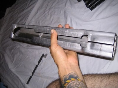

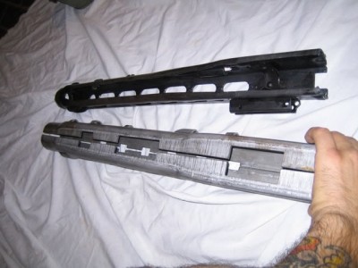

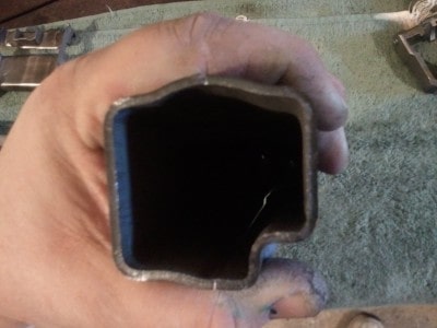

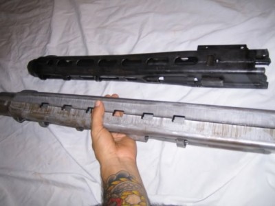

Hello, There has been some talking about using BRP stampings for a build so I thought I would go ahead and post a bunch of pix of mine. I have both the front and rear stampings. While it is true they will take alot of work they are 500 bucks cheaper than the WLA or BRP 100% rear section. As for the (cold steel? ones) well I think the material workmanship is better on the BRP's but to be honest I havent seen the cold steel ones in person.
Glenn
BTW this is my m53 in some of the pix for reference

It is the first time I have seen good photos of these, they look like they have nice sharp bends. Thank you for spending the time photographing them.

Your welcome. I noticed there aint any good pix of em either so I figured "what the hell".
Rahatlakhoom
Re: BRP stampings
Post by Rahatlakhoom »
Great pics flem.
I ordered rear stampings on Mon.
I'd wished I had started with those in the first place.
Nice sharp corners and other details.

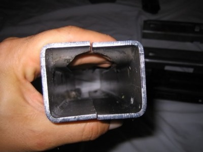

Ok, i bought those same rear sheet metal stampings from brp. I found that i actually had to have a gap on the bottom between those 2 halves to be at the correct width when welded. I determined the correct width by placing the buffer in between the halves, then i added a .013 shim to one side for clearance since the welds would shrink it. I took pics but haven't posted yet. Also of note, i made the relief cuts for the buffer to rotate properly in both halves before i welded them together. I also put as much of the buffer as i could in the front half to tack it together as well. It also helped square it up. After i was done welding,(i did NOT weld the whole thing cause most of it will be cut out anyways) my buffer was to tight so i put the receiver in a vise and gave it a little squeeze to widen it out a little. It worked great! In hind-site i should have used a slightly larger shim but.....That was my experience. If the stampings are consistent i would say DO NOT make them any skinnier! They need to be almost 3/32 wider. But ya, metal needs to be remover all over the place!

I finally got my BRP rear receiver halves yesterday. I spent the extra 75$ and got the kit with new rails, rivets and buffer tabs. On my stampings I had the same problem as mechwarrior. The top parts of the halves were way too long and the bottom was undersized. First I squared up the seams on the two halves by referencing off the sides of the stampings. I made sure to account for the expanded parts on the receiver that are used by the top cover. I made cuts until the top seam until it measured 1.100. Then I did the bottom seam and stop cutting once I got an even cut across the whole surface. Next I began cutting scrap metal and shimming the bottom until it was at 2.20http://www.mg42.us/download/file.php?id=11977&mode=view
Note how unparalleled the side are to each other. Top oversized, bottom under.
Notice the larg gap in order obtain proper width
Here is the size of shim I added to square up the receiver
