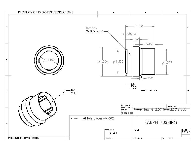

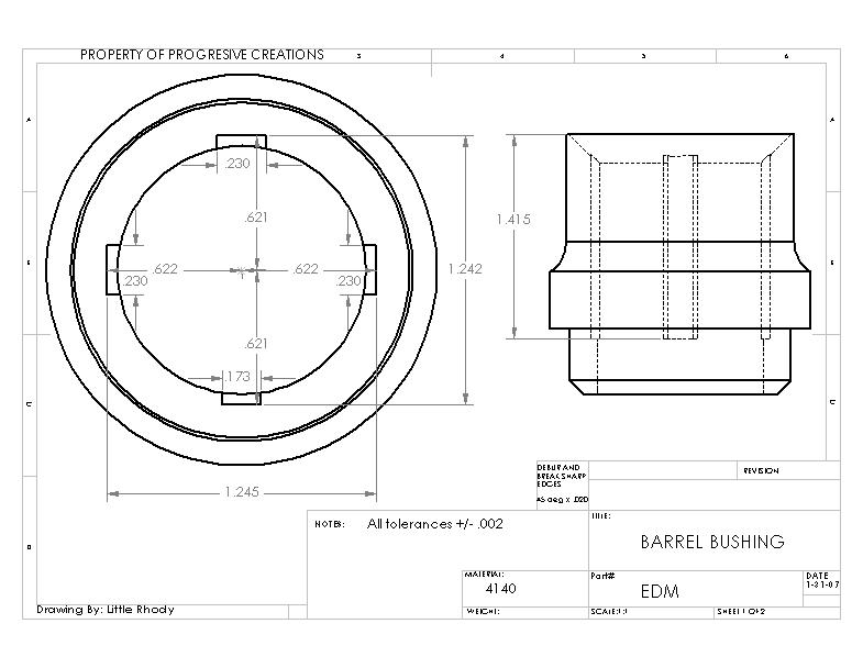

I know Wise Lite makes a very high quallity booster repair sleeve for around $149.00 but I would like to make my own. Having machined from Centry castings 2 FALs, one in 300 WSM and one in 7.62 Nato I have the equipment and machine experance to do my own. I do not intend to build them for sale or compete with the people building and selling them now. I just want to make the rebuild parts I need my self. I intend to scratch build a receiver also. I have posted else where pictures of my scratch built Mac 10 SA and scratch built 7.62x39 belt feed AK-47 based SA.
So, if any one has a drawing of the booster repair sleeve I would be very much interested.
Sharpsshooter5090
Little Rhody
Post by Little Rhody »
Here you go.
LR.

SHARPSSHOOTER5090
Posts: 143
Joined: Mon Jan 29, 2007 9:21 am
Location: UTAH
Barrel bushing
Post by SHARPSSHOOTER5090 »
That's exactly what I need. Thanks much

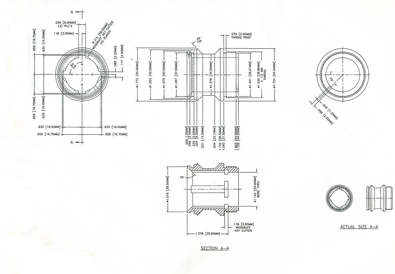

here is the blueprint of an original mg3 type someone posted months ago.
barrel guide sleeve blueprint.JPG (129.52 KiB) Viewed 3173 times

Barrel bushing print
Jet489
Thanks for the print of the barrel sleeve. My new lathe just arrived yesterday. I will spend this weekend installing it. this might be the first part I make with it.
Sharpsshooter5090

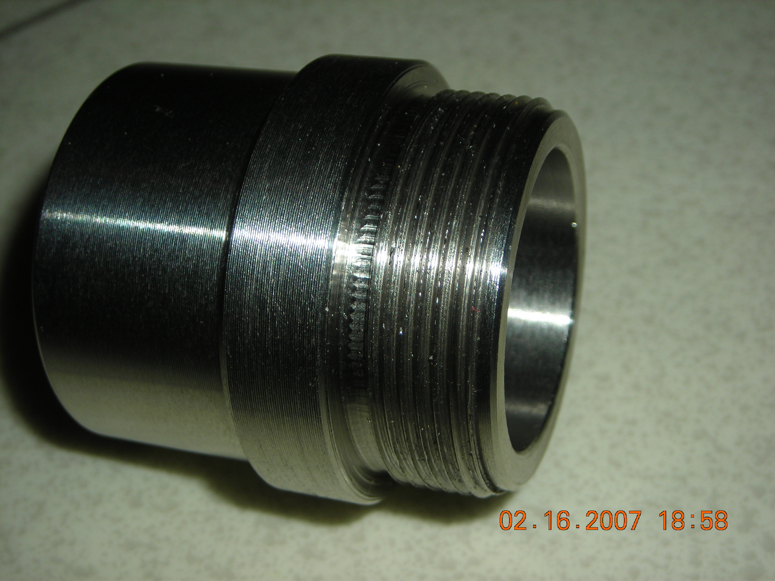

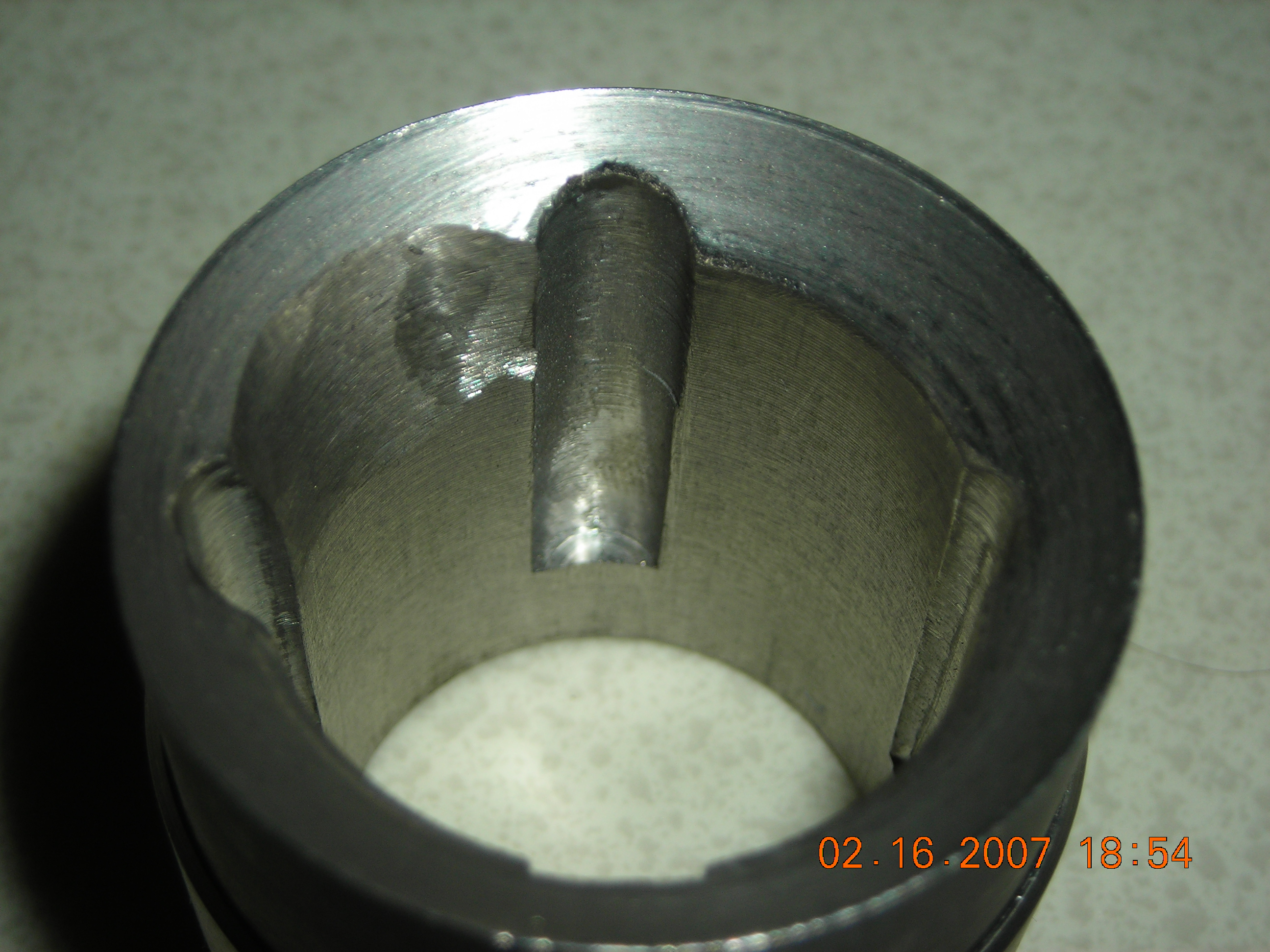

Post by jet489 »
welcome sharpsshooter5090.
here's some photos of the one i made.
since i dont have the machine to make the square keyways i made them round.
