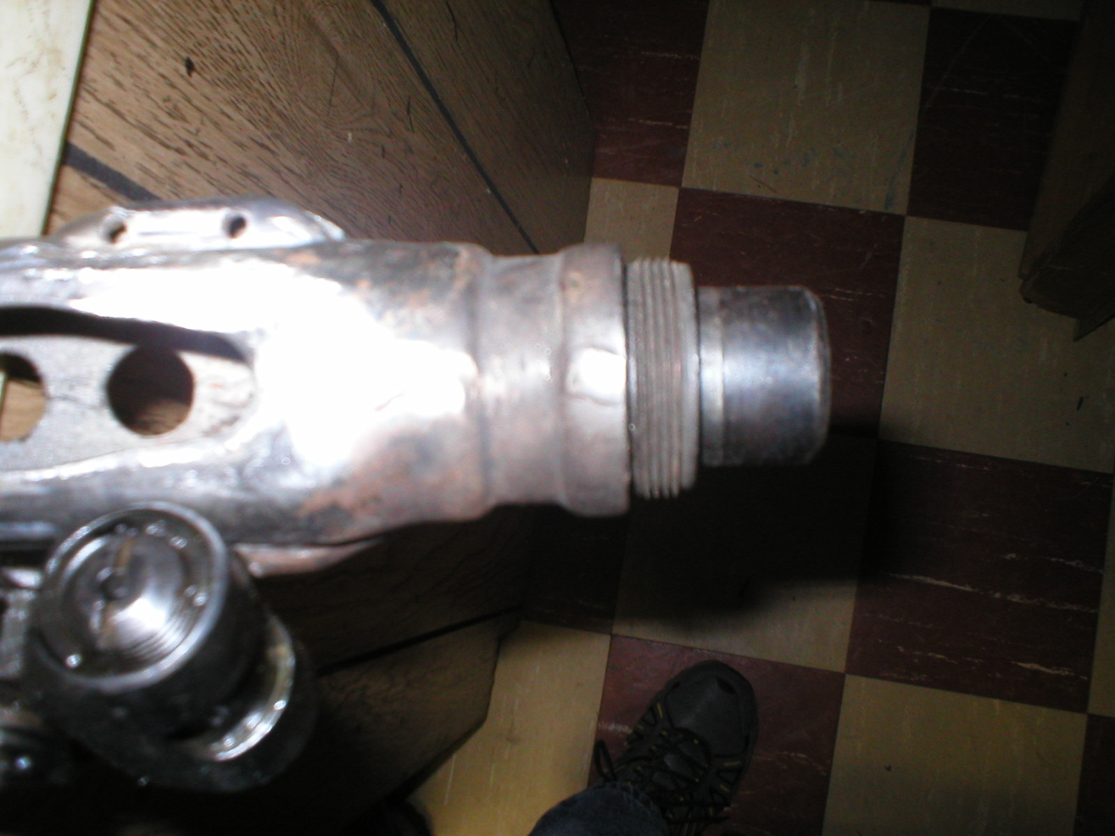

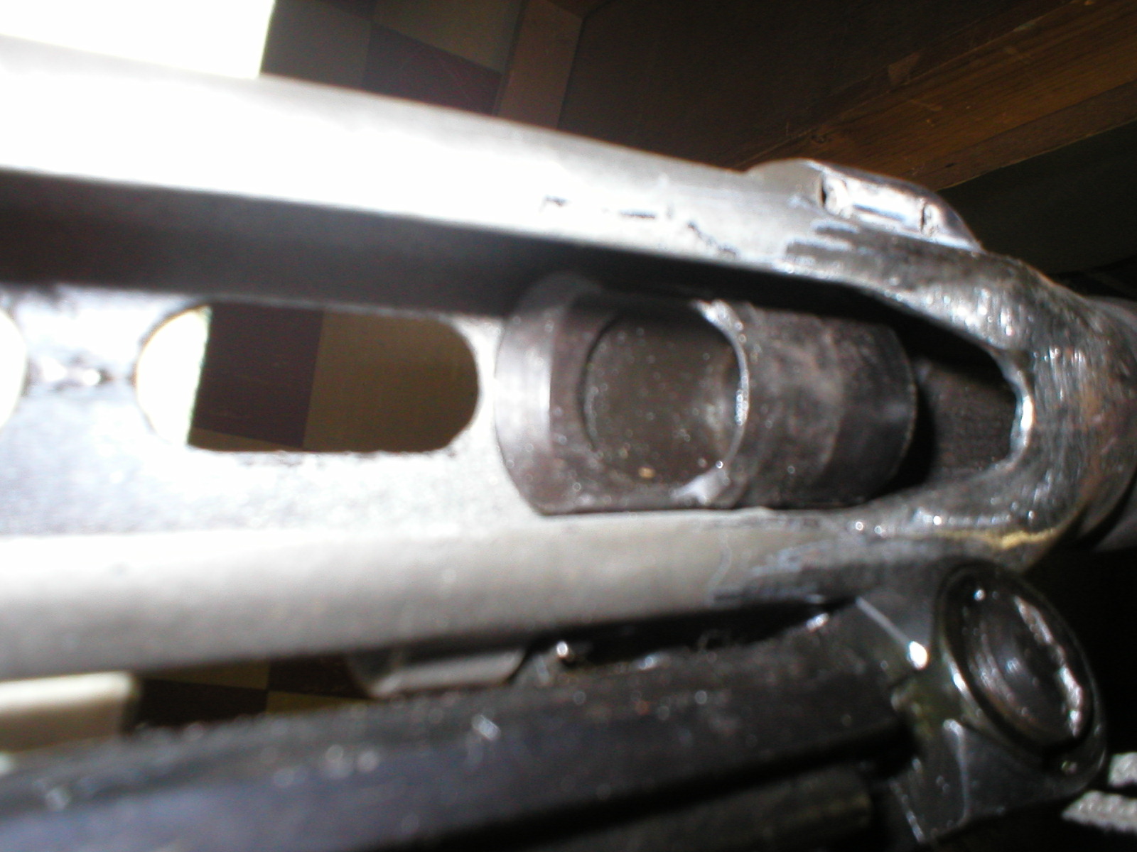

I received my receiver from pdstout this past saturday (thanks Pete! :lol: ) and all seems well except for one problem. The breach end of the barrel snugs up with the caming piece and won't go any further into the receiver as seen below. There is nothing obstructing the barrel in the booster area. What are the possible problems?

if the recop. is insalled it may be to far out
be sure the nozzle is installed in the correct clocking as shown, also be sure it is sticking out the end like thisone in pic is about 3/4" protrusion

-M60_Gunner-
Post by -M60_Gunner- »
More pics
dude first pic but with the nozzle installed so i can see it is in correct

This may sound stupid, but did you measure the overall length of the receiver?
Not trying to sell a manual here, but according to the armorer's manual, they made two styles of barrel bushings and barrels. One combination doesn't fit together. Check the barrel bushing and barrel out of the gun. Make sure the barrel bushing goes fully onto the barrel, and that the groove inside the bushing hooks onto the barrel ridge. The muzzle of the barrel should go completely up against the inside front of the bushing.
that is an excellent suggestion john, we went through this in chat last night and he tried a second barrel, i also had him install the barrel door and it will not close , looking close at the pic of the cam section he posted it looks like it is a bit forward on th barrel door side of the gun, maybe twisted a little , he is gonna try to file fit the cam section to the reciever to correct it :D
I tried telling him it was the mg3 nozzle he is using and to send it to me for a ww2 style but he did not go for it :lol:

any new or update on this gunner?
my gun we welded i had to file fit the cams to the reciever, think that is the problem here
TOM R wrote:my gun we welded i had to file fit the cams to the reciever, think that is the problem here
me too Tom. I think I spent a whole afternoon hand filing to get it just right

I also had to file the cams to get the cam piece to fit correctly. As a matter of fact there was a lot of file, try, file some more, until some of the different parts would fit. The CH track comes to mind. I spent hours until I got it to where it would move without binding. These toys aren't plug and play. They require handfitting and tweaking to get them to run. But that is part of the fun of building one. That and wiping the beads of sweat off your brow while hoping that you didn't make a major screw-up. If I wanted something simple, I'd assemble an AR.

Propos is right. Although some of the builds are different out there, I too had to to a lot of fitting one build I did. If the middle was just a little bent at all, up or down, left or right, the barrel would not insert correctly. Some barrels I have work fine, but others dont. Believe it or not, all my yugo barrels work fine, only the styer ones are the pain.
