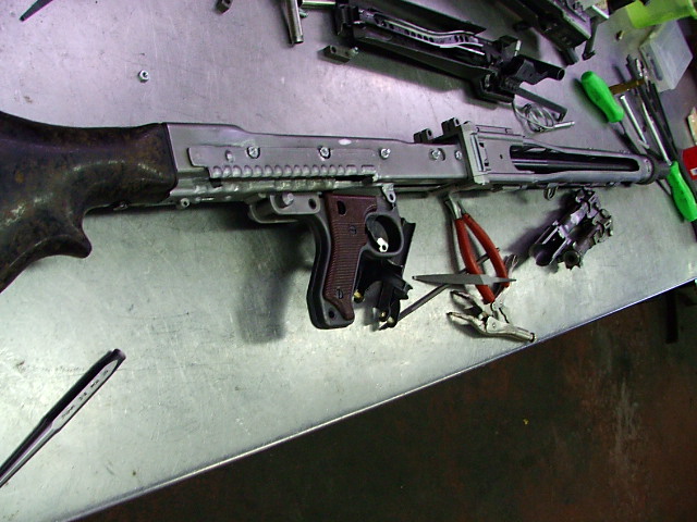

Mine works great, but you have to pay special attention to the firing pin protrusion. Put undrilled wedge in bolt head, move rollers to battery position [outside], measure pin protrusion with bolt head in upright position. Turn bolt head upside down, see that pin protrusion is now approximately .100. Now grind pin protrusion length to that measured with undrilled wedge in battery upright.This length has to be measured with pin fully bottomed in bolt head. Now you won't have all the punctured primers which can lead to an out of battery explosion that I had because a piece of primer got into the chamber and stopped the shell from seating all the way. :mrgreen: Check out pic , from ZERO to running in 5 days :lol: :lol:
MG42 Picture 003.jpg (107.97 KiB) Viewed 1392 times
