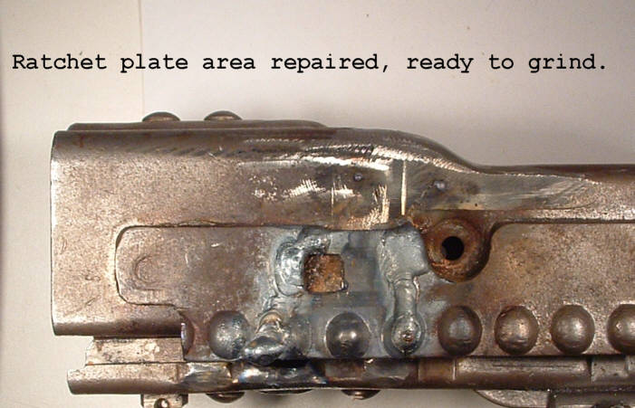

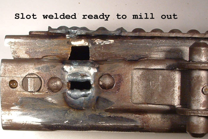

I cut a section from a scrap section of ratchet plate, it was not the correct section so I had
to cut the slot. I beveled the edges and welded it in. I also built up the slot on the bottom,
I plan on using a mill to finish this.
reconstruced slot ready to mill.
reconstructed ratchet plate.

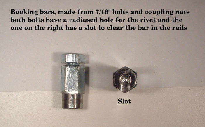

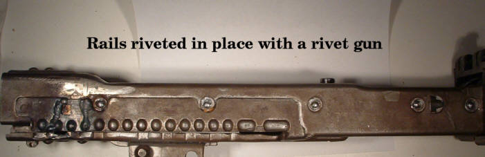

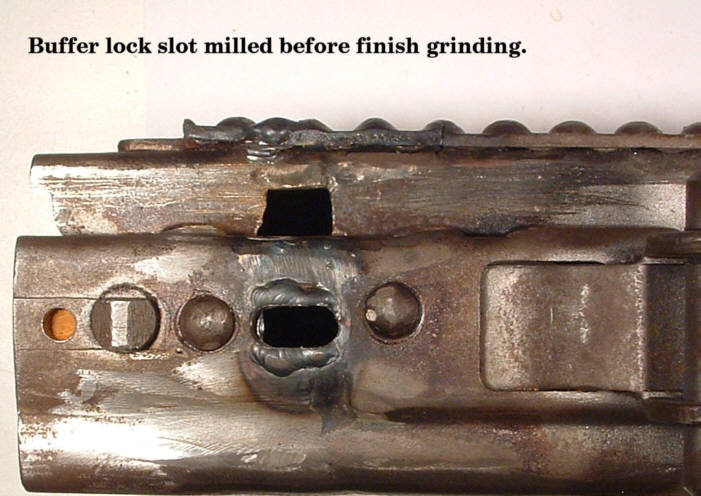

I got to use a friends lathe and mill today, I machined the slot for the buffer latch as I wanted it to
fit the latch lever properly. I made the bucking tools from 2 7/16" coupling nuts and bolts. The nuts
were shortened and the bottom was turned to rotate in the rails. Both bolts were dimpled for the
rivet heads and one was slotted to clear the small bar in the rails. I used a pneumatic rivet gun
and the setup worked good. A little more grinding and smoothing of the welds and the receiver
will be complete.
rails riveted in
rails riveted in

buffer lock slot milled

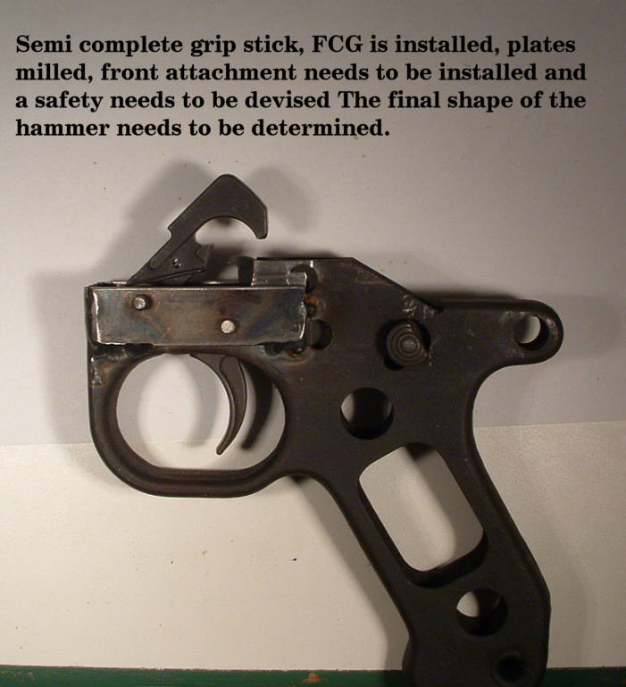

Now I am readty to do the semi mods to the bolt & gripstick. I am planning on using the
origonal mounting for the ejection dust cover, so I milled the side plates to sit flush with
the receiver. By widening the slot for the dust cover pin and reshaping the pin it should
work similar to the origonal.

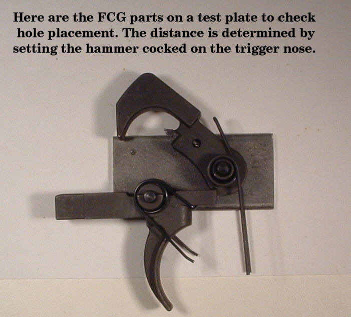

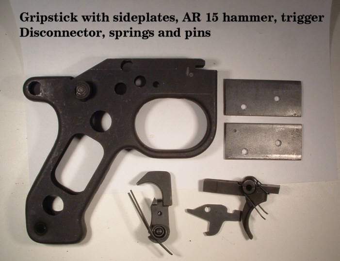

The first step is to determine the hole location for the trigger and hammer pins, I did this
by laying the parts with the hammer cocked and made a test lock. Once I determined the
holes were ok I made the side plates. The sides of the gripstick need to be cut out for
clearance and the trugger needs to be place forward enough to allow the trigger spring to
rest on the front of the grip stick. The hammer and disconnector need some reshaping to
work properly and to allow the hammer maximum travel. A trigger stop is also a good idea
to prevent trigger slap.
semi Complete gripstick
test lock frame
test lock frame
stock grip stick and AR 15 components

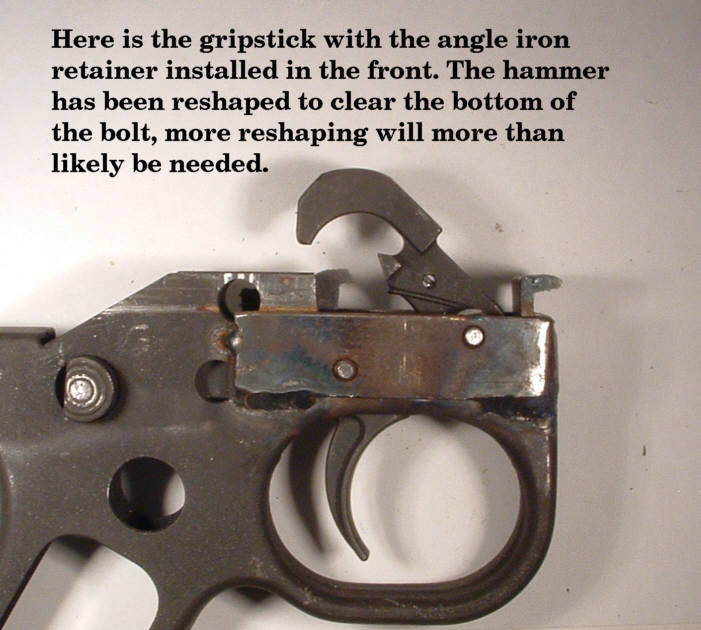

Here is a photo of the gripstick with the angle iron retainer installed and the hammer ground to
clear the bolt. I still need to figure out a safety. I am not totally satisfied with this gripstick and
will more than likely do another with some changes. At this point I want to finish the bolt
and assemble the gun to get all the parts fitted and working. After I test fire it I will tear it down,
finish grind all the welds and blast and parkerize it. But I want to see it work first.
semi finished gripstick

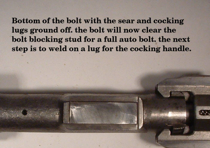

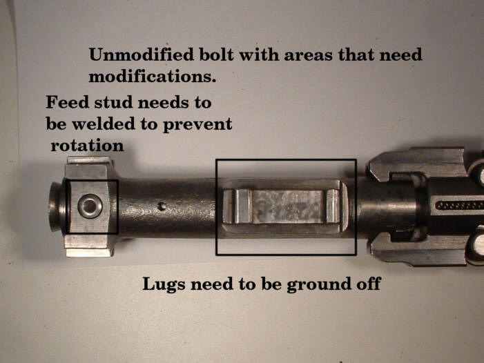

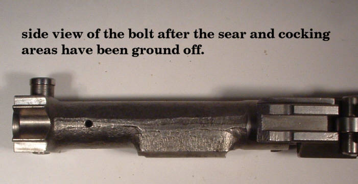

Modifying the bolt.
the sear and cocking lugs must be ground off to clear the bolt block stud installed in the
receiver. The feed stud will need to be drilled for the firing pin to pass through so it must
be welded in place to prevent rotation. A lug must be welded on to catch the charging
handle and the locking wedge must be drilled for the new firing pin.
I will be using 3/16" drill rod for the firing pin, and will drill 3/16" holes in the wedge and
stud. I will take a few thousanths off the pin for clearance as the carbide drill is
exactly 3/16".

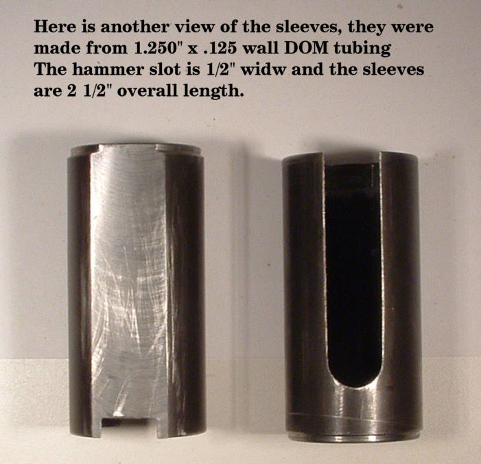

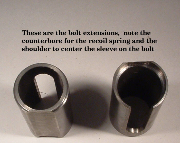

The bolt extensions were made from DOM steel tubing. One end has a counterbore to hold the
recoil spring and the other a step to center it on the bolt.
bolt extension sleeve
bolt view
bolt view
bolt view
bolt view
unmodified bolt
unmodified bolt

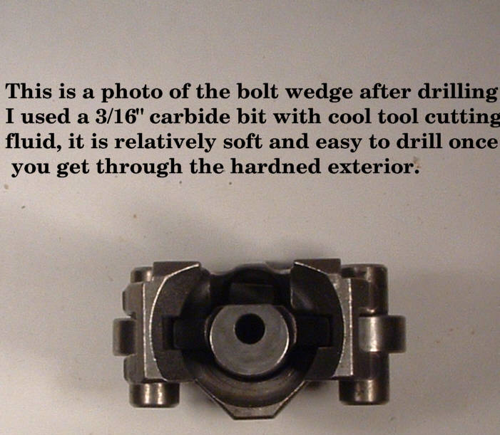

This is the bolt locking wedge drilled for the firing pin
drilled wedge.
drilled wedge.
