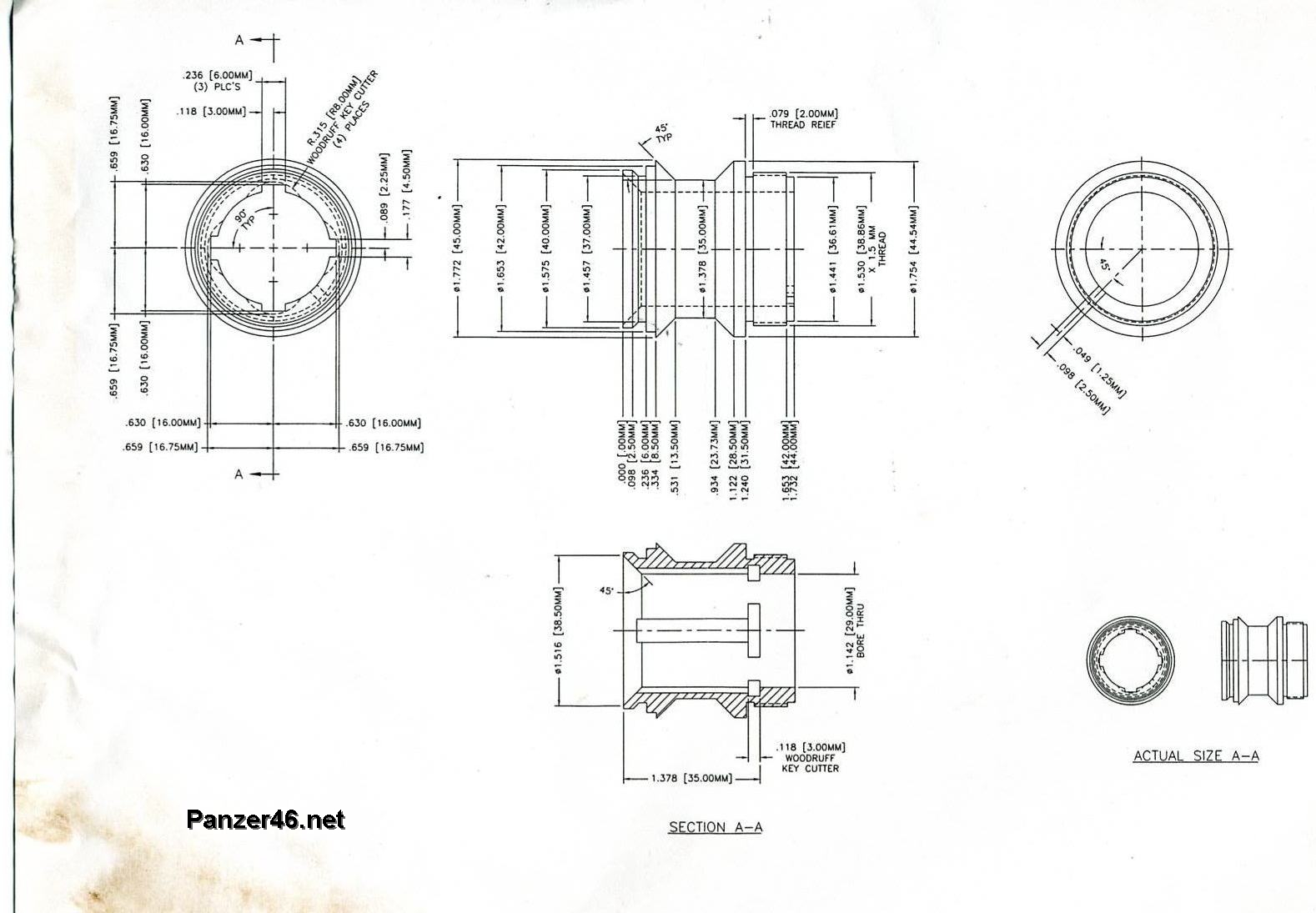

Anyone know the threading on the booster end of the MG42? Trying to make a replacement piece for the torched end....

specifications for the treaded section would be nice for all of us wanting to try to make the part, I am sorry if this has been addressed allready.

Here are the specs for a replacement barrel bushing sleeve. If you manufacture a working one, be sure to post pics of the results. Good luck.

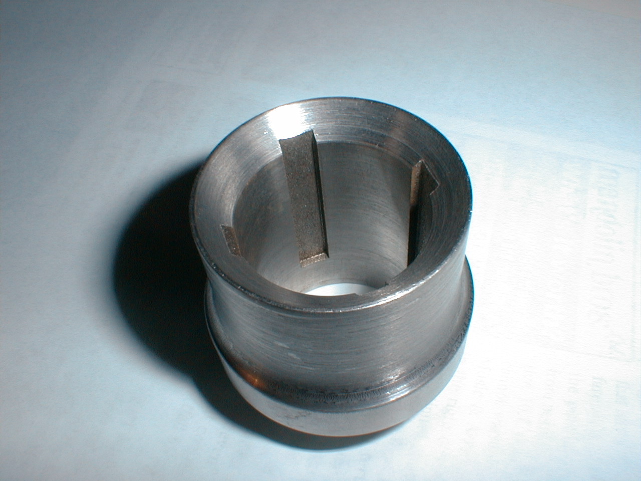

GDMOORE, you posted this schematic, but I see a few things missing from it, such as the thread data needed, and I also I don't see a notation for the proper clearance to remove the bareel. Please see my atchaed pics of an original part I removed from a demilled kit.
I'm not trying to call you out, but this data could help somone at home that may have the capability to produce there own part. I just want everyone to be aware of this. If any one has the needed specs please post them here to help our hobby.
Also I'm guessing this schematic was measured from an original part and not the one Wiselite is building. This one seems to have more shape than the aftermarket one.
Thanks for the schematic.
ADDED: I just measured the thread count, it is 16 tpi, I dont know the pitch ot the depth.
Hi L.R. -- and welcome to the board. It's been entertaining and interesting to read your and your friend's posts. You guys go after it full steam ahead don't you? :lol: I'm looking forward to reading your posts as you all start assembling your SA42s. I'm betting you will come up with some good alternate build proceedures from those already outlined here.
I didn't post the thread specification for the barrel bushing sleeve because I haven't been able to find them. I've seen requests for the specs before, but I've yet to see them posted. I'm not building my own sleeve -- bought mine from Wiselite -- so I haven't made any extraordinary efforts to find the specs. My friend had a machinist build a replacement sleeve, though, and the machinist bought the proper die to thread it. If nobody posts the specs for you soon, I will try to contact the machinist and get the specs for you.
Regarding the "divet" that you pictured, my original demil sleeve has that bevel machined into it too, and I have pictures of other originals that have it. But the replacement sleeves from Wiselite don't have the bevel. I ASSume that it may not be necessary. The Wiselite replacement sleeve is pictured from the same angle as the demilled sleeve piece that you pictured.
