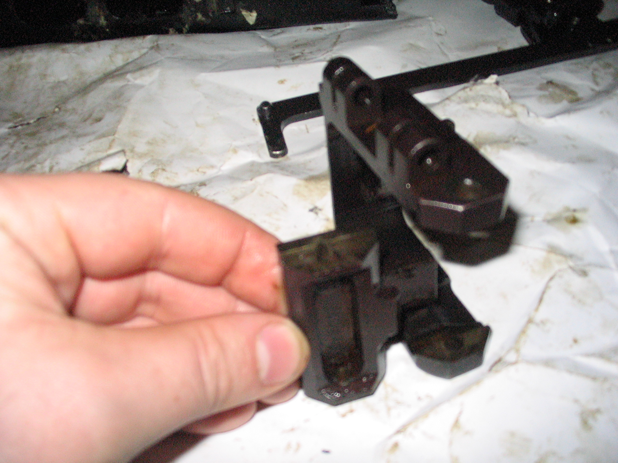

I have been going through my CFS parts kit and am also missing some small parts. I am missing a nut for the recoup and a pin that holds the machined receiver peice together that the lid pins to. Also my lid pin is broke like most everyone elses seems to be.
Is the pin that holds the machiened receiver peice together something special like the rear gripstick pin or just a bolt and nut? If any one has a pic it woudl be great.
Other than that I am very happy.
The thin peice under pin head is chipped
Picture 004.jpg (524.72 KiB) Viewed 1213 times
Peice that is missing pin.
Picture 002.jpg (1.42 MiB) Viewed 1213 times
The pin always seems to be broken,if it wasn't German,I'd say it came from the factory that way! Check the serial numbers on the 2 piecs you are holding-they should be the same. ---bil
morvedahl wrote: Is the pin that holds the machiened receiver peice together something special like the rear gripstick pin or just a bolt and nut?
Its called the CAM piece , both sections should be numbered the same or you take a big risk using different unmached parts , and its held together with a rivit availible from BRP.

Why are there so many broken top cover hinge pins. Are you sure you're not mistaking the flat on the knurled nob for a broken area? It's made that way so that the pin locks into the cam piece. A picture would help.
