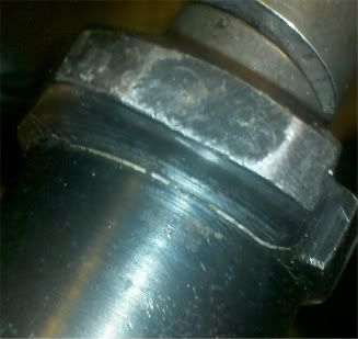

Looks like someone smacked the stock pretty hard. This crack goes all the way through but theres a lot of meat on the thicker side to hold it and it doesnt connect on either end. Is this a high stress area? The lug is raised just a hair. Id have to bang it back square and weld it. Leaning towards getting another. Thoughts?

Save the trouble of a repair, and just replace it. It's an easy part to find for a very reasonable cost.

I agree with jbaum replace it. Make sure as to which one that you replace it with yugo or German. It will not fit the buffer cup well, if you get the wrong one.
Might also want to think about what happen to make it that way. Is it from your working mg42 or a part from a parts kit? If from a currently bought parts kit ask about replacing it.

Was a parts kit but it was lacking the rear so thats no biggie. Got a 3 cut german rear its gtg. Currently waiting on new rails and bolt internals before I weld it up completely. Just the shroud and rear tacked together atm.

It is a fairly high stressed area. Difficult to weld as it is case hardened. Ask me how I know. Toss it.
