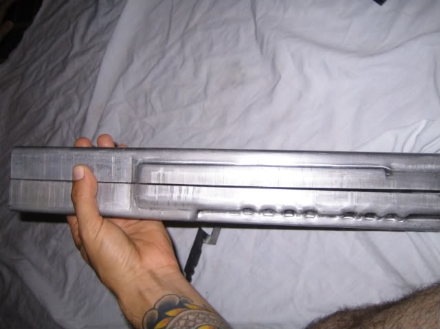

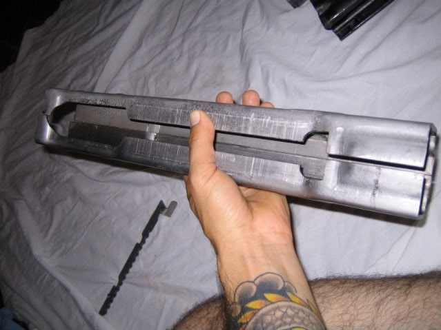

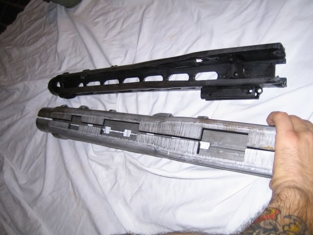

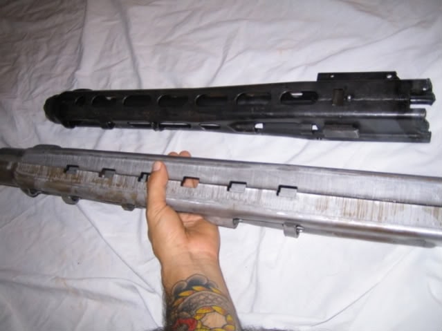

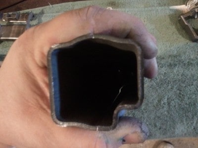

Hello, There has been some talking about using BRP stampings for a build so I thought I would go ahead and post a bunch of pix of mine. I have both the front and rear stampings. While it is true they will take alot of work they are 500 bucks cheaper than the WLA or BRP 100% rear section. As for the (cold steel? ones) well I think the material workmanship is better on the BRP's but to be honest I havent seen the cold steel ones in person.
Glenn
BTW this is my m53 in some of the pix for reference

It is the first time I have seen good photos of these, they look like they have nice sharp bends. Thank you for spending the time photographing them.

Great pics flem.
I ordered rear stampings on Mon.
I'd wished I had started with those in the first place.
Nice sharp corners and other details.

Was there much metal to take down on each half for the rear to get it to the right dimensions? Im currently looking into getting the pieces to start my m53 build. I've been away for a while. Also does BRP provide any template to use for cutting the slots in the rear? I know they include blueprints , sounds like a good winter project in my future!
Dan

There is a ton of metal to remove... from everywhere. I dont remember what the blueprints looked like to be honest with you

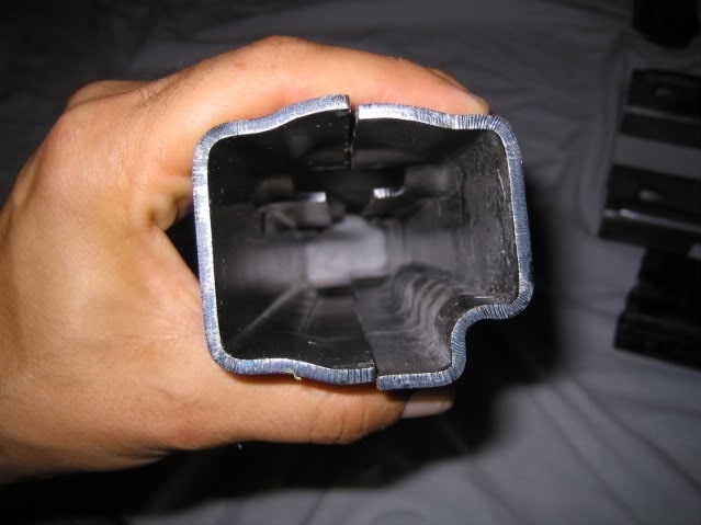

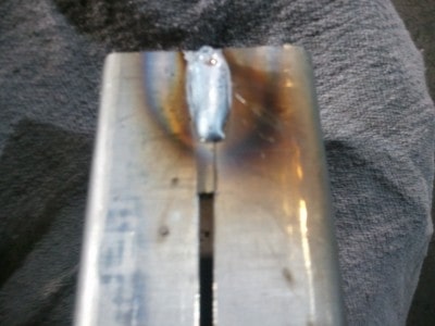

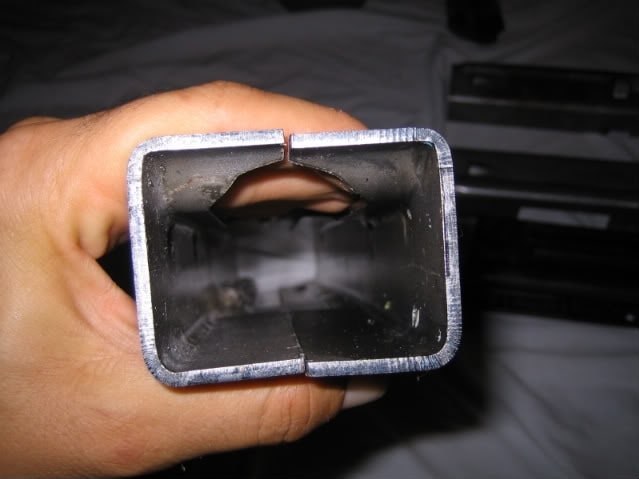

Ok, i bought those same rear sheet metal stampings from brp. I found that i actually had to have a gap on the bottom between those 2 halves to be at the correct width when welded. I determined the correct width by placing the buffer in between the halves, then i added a .013 shim to one side for clearance since the welds would shrink it. I took pics but haven't posted yet. Also of note, i made the relief cuts for the buffer to rotate properly in both halves before i welded them together. I also put as much of the buffer as i could in the front half to tack it together as well. It also helped square it up. After i was done welding,(i did NOT weld the whole thing cause most of it will be cut out anyways) my buffer was to tight so i put the receiver in a vise and gave it a little squeeze to widen it out a little. It worked great! In hind-site i should have used a slightly larger shim but.....That was my experience. If the stampings are consistent i would say DO NOT make them any skinnier! They need to be almost 3/32 wider. But ya, metal needs to be remover all over the place!

I finally got my BRP rear receiver halves yesterday. I spent the extra 75$ and got the kit with new rails, rivets and buffer tabs. On my stampings I had the same problem as mechwarrior. The top parts of the halves were way too long and the bottom was undersized. First I squared up the seams on the two halves by referencing off the sides of the stampings. I made sure to account for the expanded parts on the receiver that are used by the top cover. I made cuts until the top seam until it measured 1.100. Then I did the bottom seam and stop cutting once I got an even cut across the whole surface. Next I began cutting scrap metal and shimming the bottom until it was at 2.20http://www.mg42.us/download/file.php?id=11977&mode=view
Note how unparalleled the side are to each other. Top oversized, bottom under.
Notice the larg gap in order obtain proper width
Here is the size of shim I added to square up the receiver
