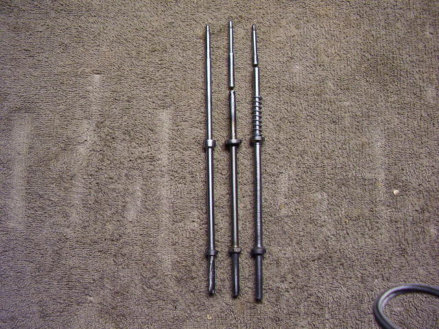

Information only here for what I used. I use a modified version of pirate's design. The firing pin extension I turned in a lathe is .600" longer in the front, and I cut .600" off the original firing pin. Made it lighter and elimated slam fires. I have tried wolf .308 to reloads and no more slam fires useing non arsenal primers for reloads. That is what I want as a design for reloaded ammunition.
The pins in the picture are three different designs, left being a one piece, the middle is pirates design, and the right is the design I have described above. It works like a champ.
