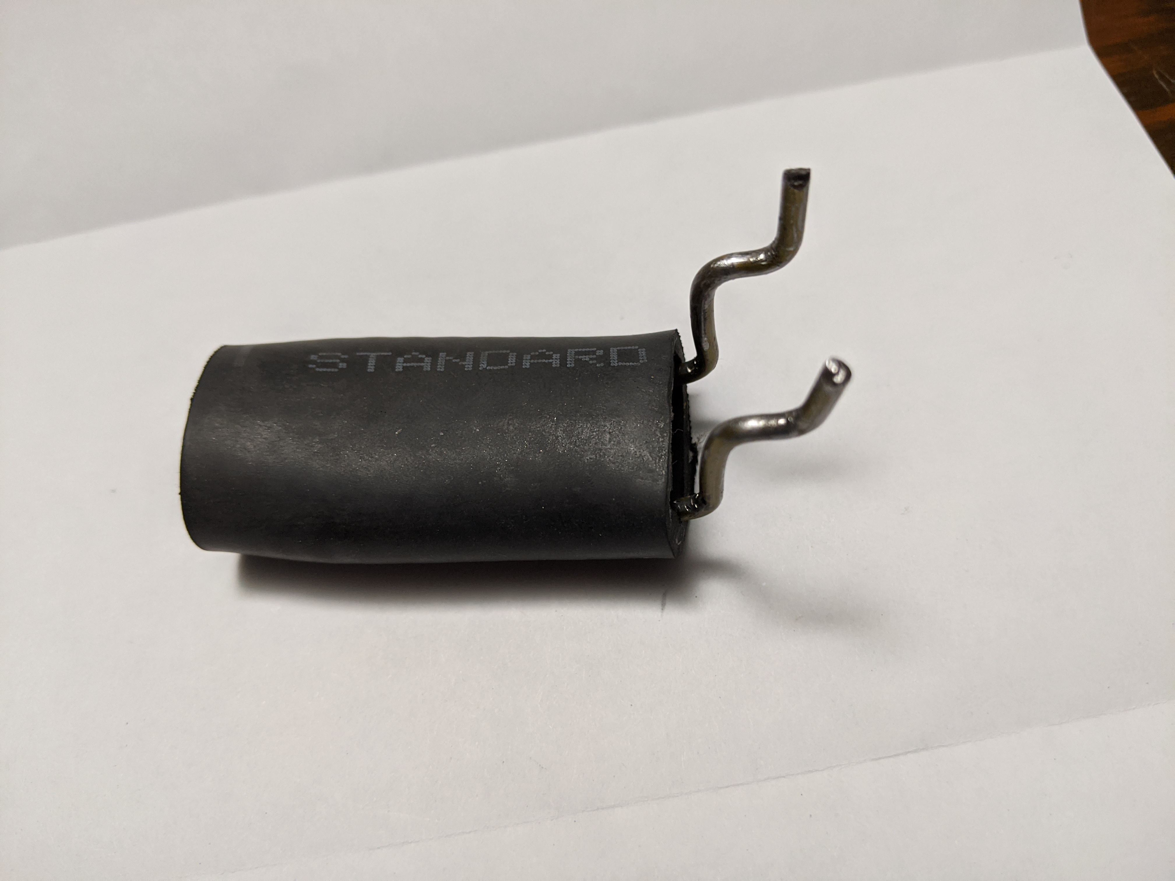

The MG42 ejects the fired shell with such force, that the case mouth is dented when it spins into the trigger guard. This makes it very difficult to reload the brass.
Here's what I made to stop that.

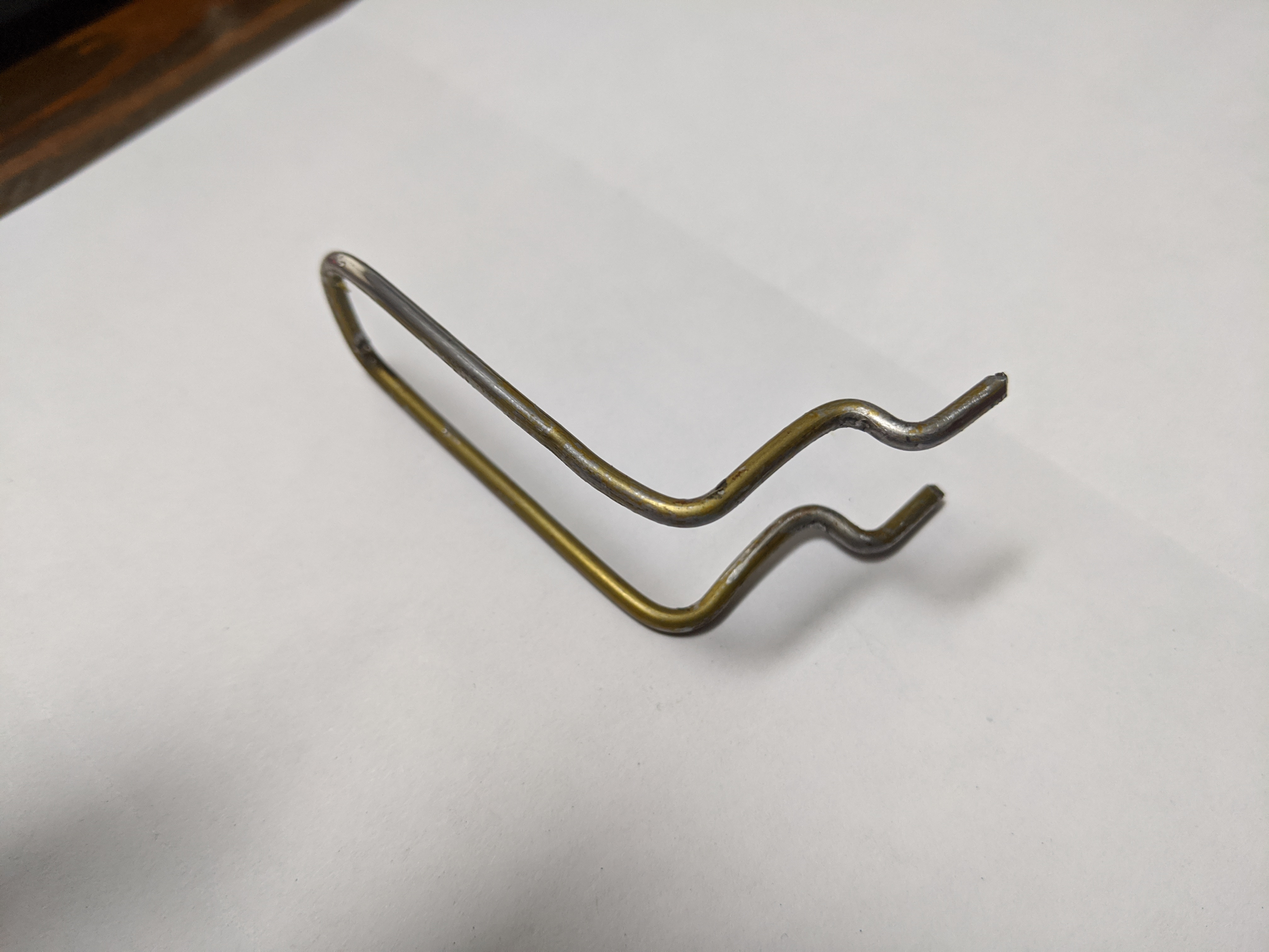

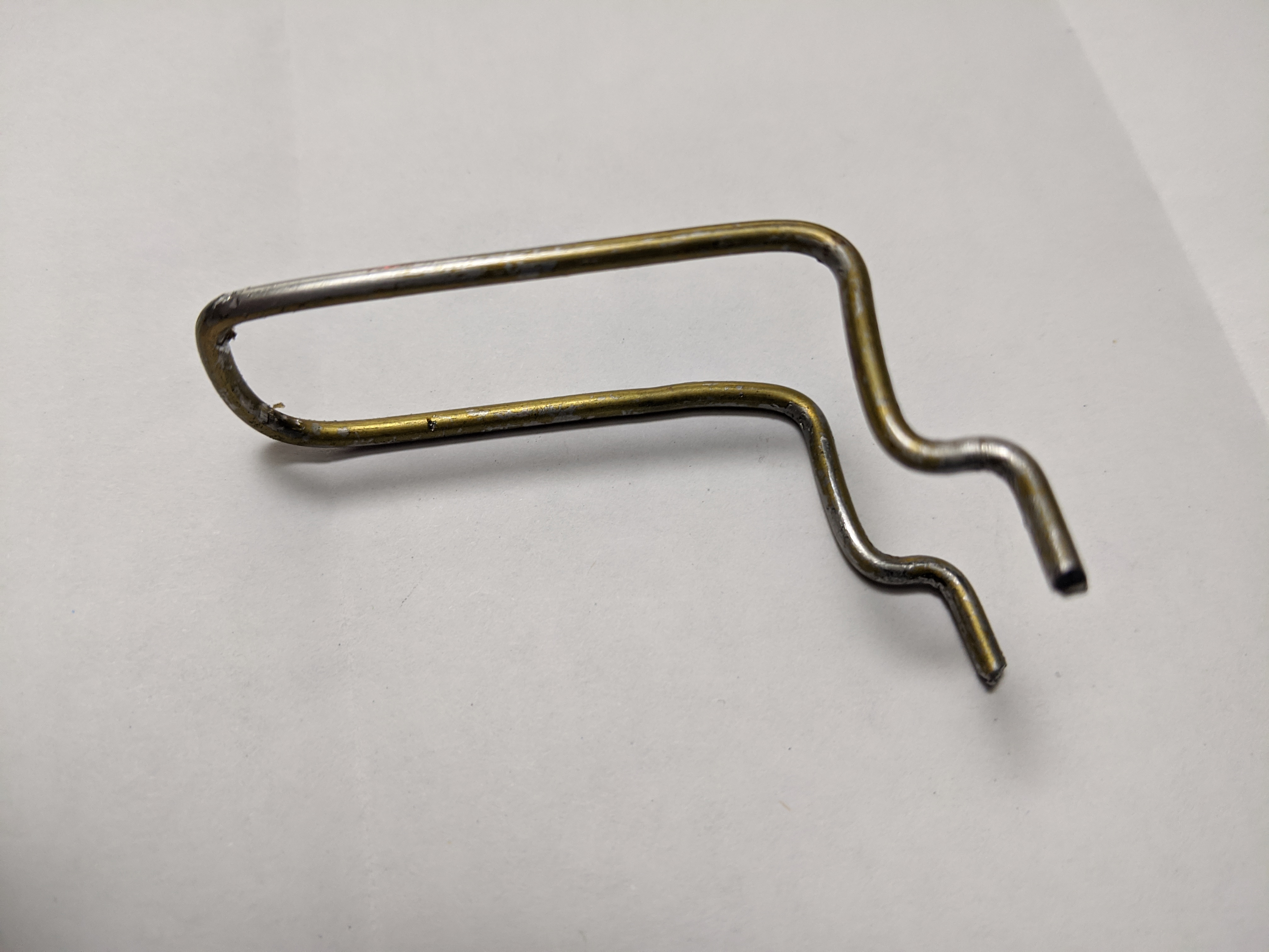

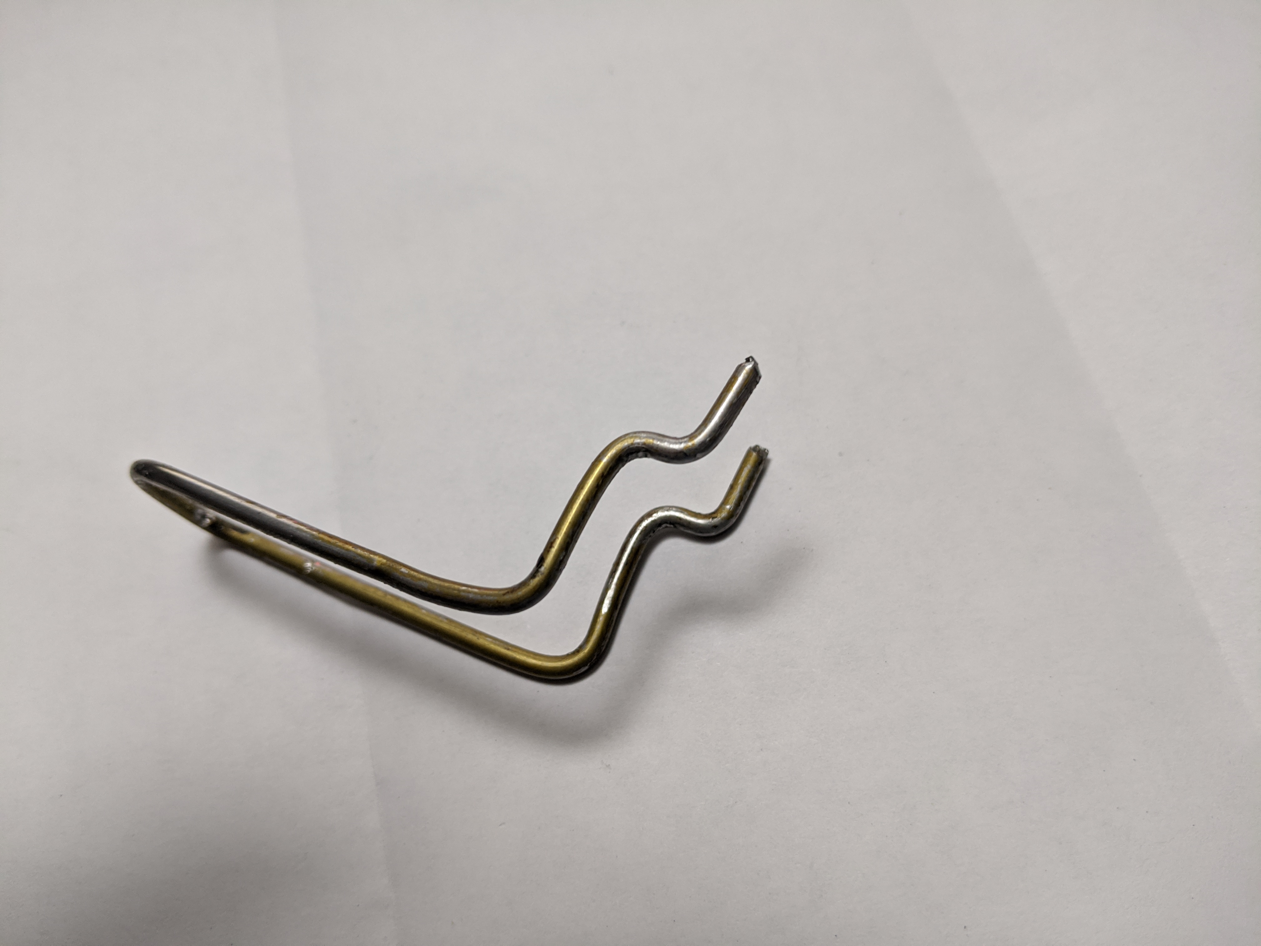

Make this from a piece of coat hanger about 3/32" in diameter.

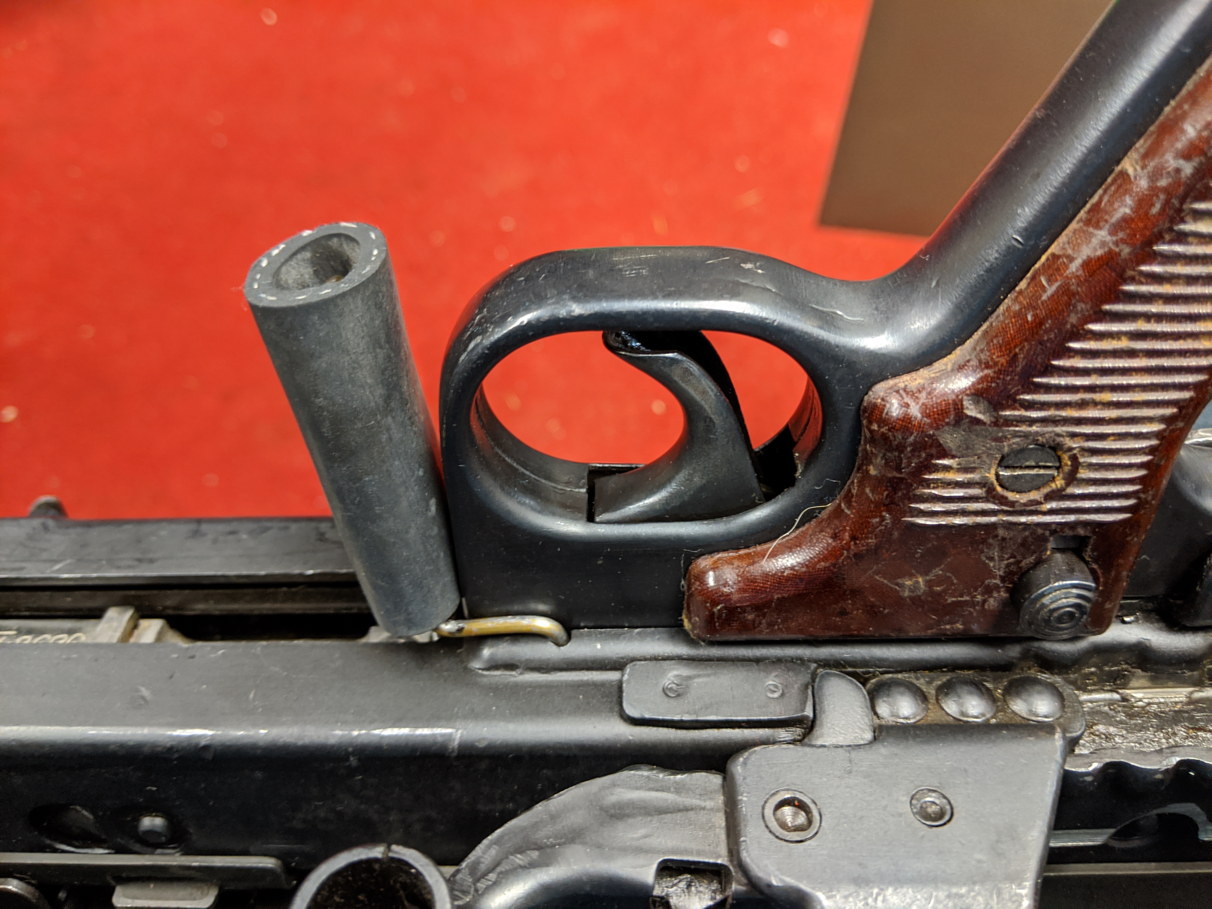

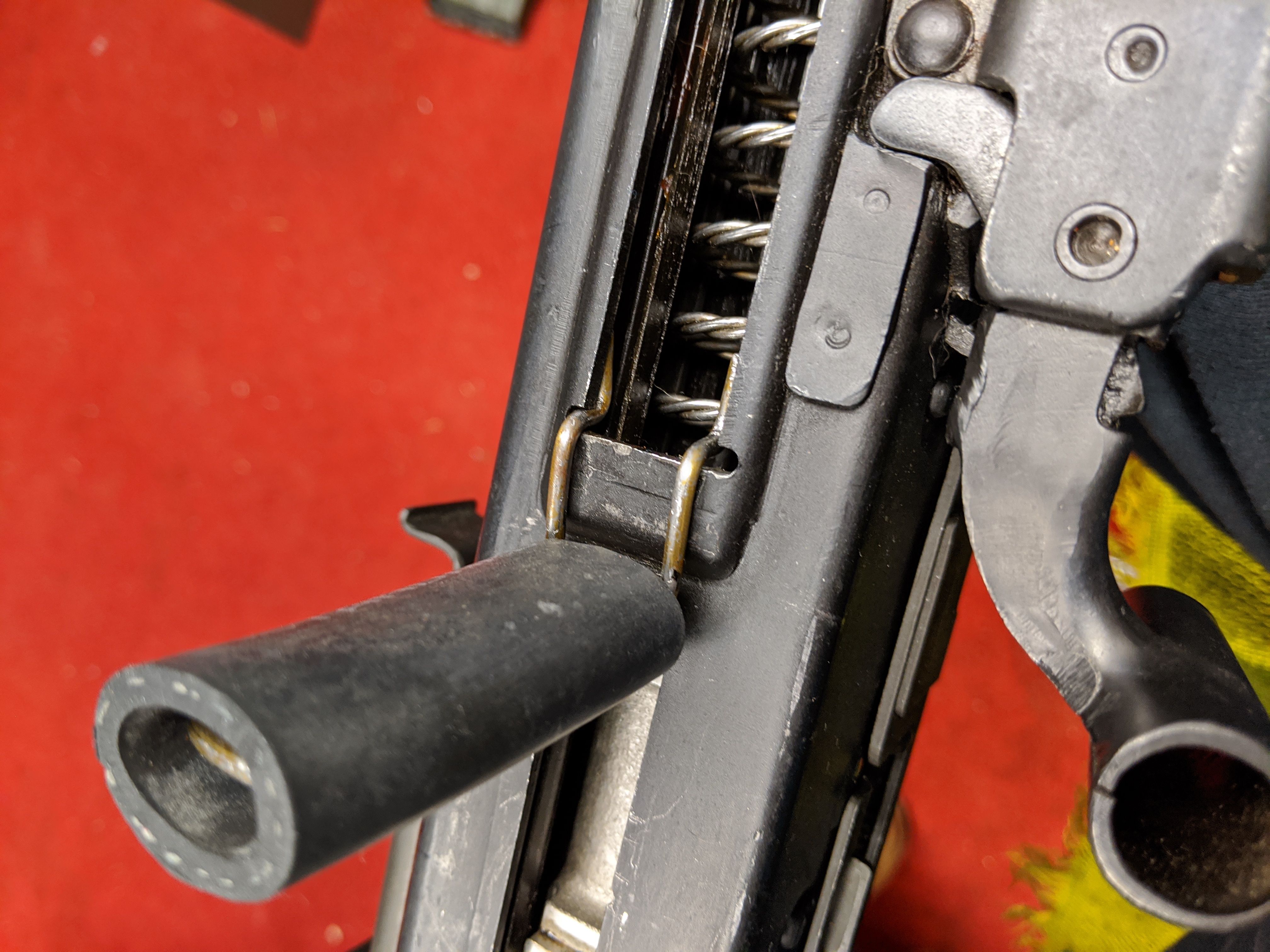

Leave the rubber hose off the wire for now. Remove the grip and dust cover. Insert the zigzag ends into the MG42 grip holes (where the axle for dust cover goes. There is a small hole in the receiver on each side that isn't covered when the grip is in place. The wire fits in there, then the grip is reinstalled. Leave the dust cover off. Slide the rubber hose over the wire (you'll need to squeeze it flat to do that, but it stays on very well if the bottom of the bumper is slightly wider than the holes next to the grip).
Now when you shoot, the rubber hose will protect the case mouth of the empty shell from being damaged.
